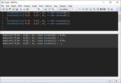

Also, in general what are is your decimal separator? If it is comma, it could be causing the issue. You can also first try to "solve" this in JMP Script Editor to avoid all possible "issues" JMP table could be causing
Show(Num(Left("0.01 - 0.02", 4), << Use Locale(0)));
Show(Num(Left("0,01 - 0,02", 4), << Use Locale(0)));
Show(Num(Left("0.01 - 0.02", 4), << Use Locale(1)));
Show(Num(Left("0,01 - 0,02", 4), << Use Locale(1)));
Num() will return missing value if it isn't able to convert the string to a number.

Num(Left(:Column, 4), << Use Locale(0))
-Jarmo

Yes, my decimal separator is a comma.
The problem was only solved when using the Left function. Do you know why the Substr function didn't work?

I would think Substr(x, 1, 4) works exactly the same as Left(x, 4) so my guess is that in your formula, with Substr, you are just missing comma after Substr
Num(Substr("0.01 - 0.02", 1, 4), << Use Locale(0))
-Jarmo
