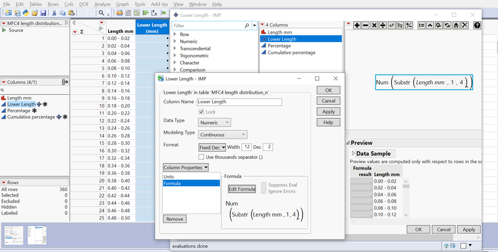

I need help to solve a problem with a colum formula result error that I am having with my JMP.
It is important to mention that this error apparently happens only with my JMP. When a collegue in another company uses the same formula in their JMP it works perfectly, and surprisingly, when they send me the JMP Data Table with this formula it works pretty well im my JMP. So the problem is when I start a JMP Data Table from scratch.
I think that the problem is in the settings but could not find it. Could anyone help me with that?

Apparently, the issue is related to my decimal separator, which is a comma.
When I use the formula suggested by @jthi it works pretty well.
Anyway, thanks for your help!
Num(Left(:Length mm, 4), << Use Locale(0))
