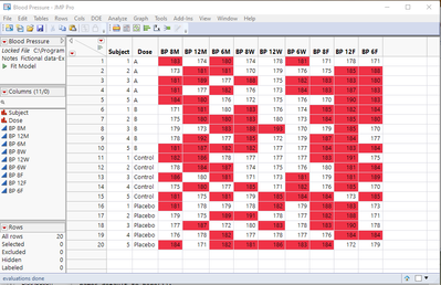

Here is a simple example of coloring cells across multiple columns, without having to process the cells row by row.
Names Default To Here( 1 );
// Open Data Table: Blood Pressure.jmp
// → Data Table( "Blood Pressure" )
dt = Open( "$SAMPLE_DATA/Blood Pressure.jmp" );
For( i = 3, i <= N Cols( dt ), i++,
	theRows = dt << get rows where( As Column( dt, i ) > 180 );
	Column( dt, i ) << color cells( "red", theRows );
Jim
