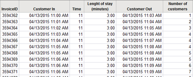

Hi, I am trying to identify how to add values if they are within a certain range, i have tried col sum but I do not know how to do compare the table values, (new to scripting )
the idea is that i have customers coming in at a certain time, stay for x minutes and leave, as the get in to the area, occupancy (number of customers) increase, if they are together within a certain time range.
I'd really appreciate guidance, thanks.

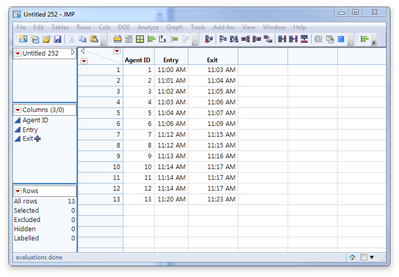

First, I created a data table similar to your example. In this form the data is agent-centric with the entry and exit events recorded in the same row. We need to separate the events by stacking the events.

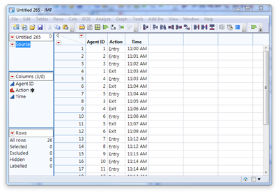

Now the events have been separated, but by default they are still grouped by the Agent. We need the events in order by time, so the data table needs to be sorted. Before sorting, we also need to make sure that exits occur before entries. The latter may not be important for your purpose, but we always deal with systems with limited capacity, so entry and exit events that have the same timestamp need to be ordered as exit then entry, as the it is most likely that an agent exits a location before a new agent enters. Once that is done we sort the data table by Time and Action.

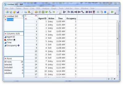

Now that the events are in the proper order, a column can be added to track occupancy.
The Occupancy column has a formula that determines the occupancy in each row based on the previous occupancy and the action in the current row. The formula also assumes that the first row is the first entry—it should be—and sets the occupancy to 1 for the first row. Now we need to split the table so that we get the original table orientation back with the occupancy reported.
