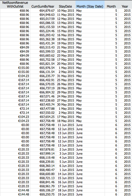

Hello,
I would like to create a column which calculates another columns mean or sum but I would like to specify the function by :
Let’s say if we select the year the calculation to be occured by "Year" or,
Let’s say col (sum) of NetRevenueWithoutVat by Year or "NetRevenueWithoutVat" by "Month (Stay Date)" or
Col (Sum) functions of specific row numbers...
Would anyone please share his/her knowledge how to do it in scripting or by entering the Col(Sum) function as a formula in a column?
The logic behind it?
Many thanks in adance

Use ColSum() in column formulas. The formula Col Sum( :NetRevenueWithoutVat, :Year ) will return the sum (not the cumulative sum) grouped by Year.
Try this formula for a ColSum() that changes dynamically with row selection:
Col Sum( :NetRevenueWithoutVat, Selected() )

saitcopuroglu
Level IV
Re: Col (Sum) function by selecting specific rows
Thank you!
This is what I was looking for.
Does that mean I could go further and let's say Col Sum( :NetRevenueWithoutVat, :Year, :Agency )  ?
Yes, more than one grouping variable is supported.
