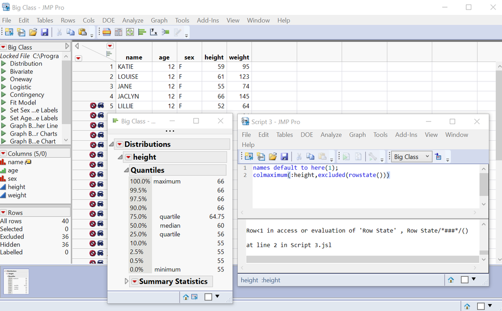

On one computer it works:
And on the another it fails:
-Dave

It looks like it is used with a column formula where the Row() function is defined as it is evaluated.
Re: Col Functions and Row States
According to the documentation, when a By variable is specified the function should be used in a column formula or For Each Row():
(Optional) A By variable to compute statistics across groups of rows. Use the By variable in a column formula or in a For Each Row() function.
In reviewing some of the examples from earlier in this post, I would agree that it appears to be treating excluded values as their own By level.
