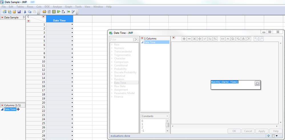

I have a data table where I have multiple date with times. I'm trying to change all the dates into just the month and maybe even a month-year format.
I know I've done this before by selecting the column going to formula and putting together Month(DateandTime) than I would use recode to change numbers into Jan. - Dec.
When I'm trying today, the Month() formula is changing my date to just dots. I've looked at other posts and the formula is what I'm suppose to be using. I'm not sure why I'm not getting my expected result?

I assume the issue is that the column you are referencing in the Month() function is not a JMP date or date time value.  Could it be that the column referenced is a character string column and not a numeric?
If you could attach a sample of the data table you are working on it would be helpful.

Herrera5238
Level III
Re: Col Formula Month()
Jim,
I was getting to ready to say it still wasn't working and got my screen shot ready.
I realized what the issue is. I was trying to use the formula on the same column I was referencing.
What I should have been doing was making a new column and adding the formula here.
Once I did that I had no issue.
I appreciate the help, I feel terrible because it was something so simple that I missed.

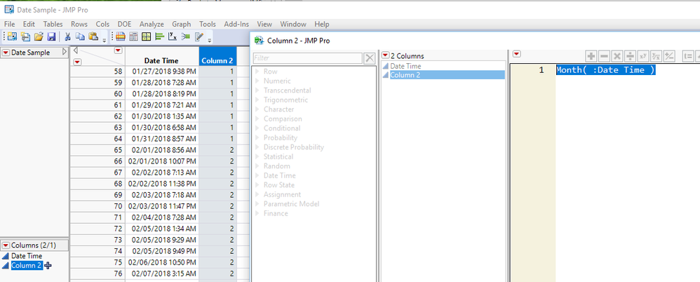

jules
Hi @Herrera5238,
On your dataset this seemed to work fine for me using the following formula:
Month( :Date Time )
Also, if you will be recoding to change the month numbers to month abbreviations, you could use the following formula directly:
Substr( Format( :Date Time, "Monddyyyy" ), 1, 3 )
I've attached your example data table here with those column formulae.
