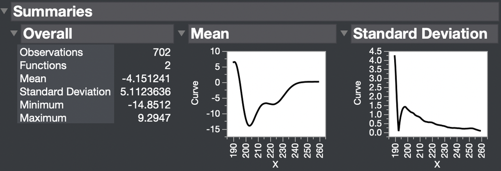

The summary of your curves shows the common shape (mean function) and the variation (standard deviation function), which is greatest at the start of the curve.

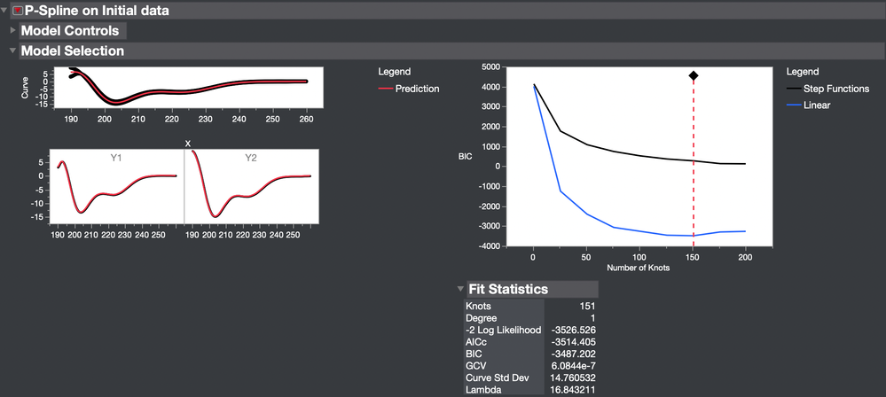

The penalized spline model gave the best fit.

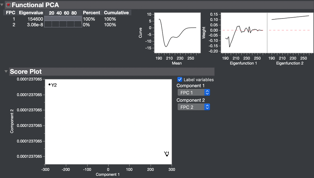

In your case, there seems to be only one shape.

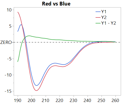

Plot data, and difference in greenPlot data, and difference in green
Plotting the difference (green) between the two curves shows something that is hard to see from the red and blue curves because of the steep slope: the difference is smoothly getting smaller after 198 or so.

I have a question for you. You say that the 2 curves Y1 and Y2 are similar. And I agree with you. But how the score plot should be interpreted? The two points are far each other.
Thanks Felice
Re: How to prove similarity between two curve? What are different approach or options in JMP?
Yes, there is a difference between the two curves. They are not identical curves.
The first functional principal component captures essentially all the variation between the two curves. FDE usually works with a larger sample so that the FPCs tend to separate the fixed effects (attributable) and random effects (not attributable). The fixed effects dominate the first FPCs and the random effects dominate the last FPCs. You have only two curves so only two FPCs are possible. There is only one difference between curves so only one real FPC.
Be careful about judging distance in this plot. (The vertical dimension has zero length.) Rather, the plot simply indicates that the two curves Y1 and Y2 are most different out of all the curves, but these two curves are the only curves in the sample.
