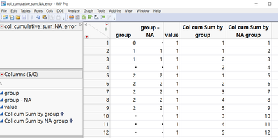

I found this behavior while using the Col Cumulative Sum() as a way to create a counter.
If the group column has a missing value in the first row, the groups are completely ignored, see the last column below.

I replicated you findings.  There also seems to be a relationship between missing values and the starting value of zero.  Put a valid, but non zero value in row one and different results are shown.
