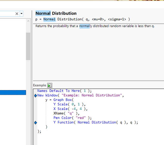

Here is the entry from the Scripting Index for the Normal Distribution function which returns the probability for a given value, with a given mu and sigma.
So if I am understanding your question correctly, you would specify
p=normal distribution(3, col mean(:x), col stddev(:x) );
Jim
