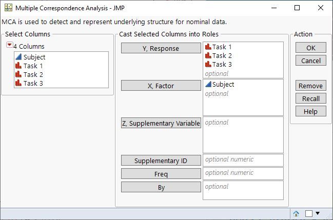

It is not a JMP Pro feature. It is available in JMP 14. Select Analyze > Multivariate Methods > Multiple Correspondence Analysis and complete the launch dialog like this:

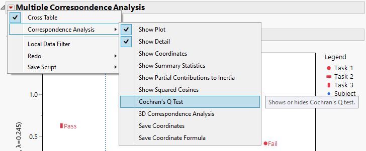

Click the red triangle at the top of the platform and select the command like this:

I found on the website of the JMP, there exist specific steps about cochran's q test, like below
1.Select Help > Sample Data Library and open Cohcrans Q.jmp.
2.Select Analyze > Multivariate Methods > Multiple Correspondence Analysis.
3.Select Task 1, Task 2, and Task 3 and click Y, Response.
4.Select Subject and click X, Factor.
5.Click OK.
6.Click the Multiple Correspondence Analysis red triangle menu and select Correspondence Analysis > Cochran’s Q Test.
But I cannot find Cochran’s Q Test button finally in my app version.
Is that because of the app version problem? Or I need to have an add-in?
Many thanks!
You should see the result at the bottom of the platform like this:
