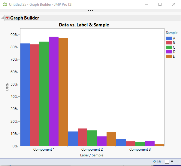

Hi all,
This might sound like a simple question but I haven't figured out a way to make this work.
I ran a test on multiple samples and for each sample, the test outputs the percentages of the three different components that make up the sample.
I set up a data table with 4 columns: 1 for sample name and the other 3 for the percentages of the 3 components.
I'm trying to create a clustered bar chart as shown in the attached picture (done in Excel), where the data are grouped into 3 different clusters, corresponding to the 3 components.
I know that I could try stacking all the component columns first ("Clustering by Variable" described here); however that would make it into a super long table and hard to navigate (I have multiple types of tests, each outputting different components). Also, I would need to have 2 separate tables, one for the original data format which is easier to navigate and another for the clustered bar charts.
I'm thinking of two different methods to get around this.
1) For each test, plot the results for each component side by side. Is there a way to have them all share the same y-axis?
2) Using the column stacking method, is there any way I can combine the two tables into one so that I could have a saved script in the original table that would generate the clustered bar charts automatically as I click it? I'm aware that I could save the script that generates the stacked table but then I would still need to re-make the clustered bar charts.
Thank you!

I was able to reproduce your graph with a simple Stack and then a Graph Builder.
Names default to here(1);
dt = New Table( "Example",
	Add Rows( 5 ),
	New Column( "Sample",
		Character,
		"Nominal",
		Set Values( {"A", "B", "C", "D", "E"} )
	New Column( "Component 1",
		Numeric,
		"Continuous",
		Format( "Percent", 7, 2 ),
		Set Selected,
		Set Values(
			[0.828470097854734, 0.8212191631319, 0.842324016243219,
			0.882067339960486, 0.872661964339204]
	New Column( "Component 2",
		Numeric,
		"Continuous",
		Set Selected,
		Set Values(
			[0.116772082395202, 0.140967620703167, 0.125925316195233,
			0.0770373142695993, 0.113037678561007]
	New Column( "Component 3",
		Numeric,
		"Continuous",
		Set Selected,
		Set Values(
			[0.0547578197500645, 0.0378132161649326, 0.0317506675615479,
			0.0408953457699151, 0.0143003570997886]
dtStack = dt << Stack(
	columns( :Component 1, :Component 2, :Component 3 ),
	Source Label Column( "Label" ),
	Stacked Data Column( "Data" )
dtStack << Graph Builder(
	Size( 534, 454 ),
	Show Control Panel( 0 ),
	Variables(
		X( :Label ),
		X( :Sample, Position( 1 ) ),
		Y( :Data ),
		Overlay( :Sample )
	Elements( Bar( X( 1 ), X( 2 ), Y, Legend( 33 ) ) ),
	SendToReport(
		Dispatch(
			"Label",
			ScaleBox,
			{Label Row( 1, {Automatic Tick Marks( 0 ), Show Major Labels( 0 )} )}
		Dispatch(
			"Graph Builder",
			FrameBox,
			{DispatchSeg( BarSeg( 1 ), Set Width Proportion( 1 ) )}
Jim

Thank you!
I've never done scripting in JMP but I was able to merge the stack script from original table and graph builder script from the stacked table into one with a little modification and got it to work. A new table still needs to be generated but at least I'll only have one table to keep.
Sounds like I'll need to start learning to script in JMP to make my life easier.
Out of curiosity, is there any function in JMP that allows me to "record" what I do on the user interface into script?

The answer is yes.
The JSL I posted was mostly written by JMP.  Every Platform that you run, and each of the File==>Tables operation that you do, will surface the JSL that will regenerate the data tables or displays that were interactively created.
When you create a new data table by stacking, the "Source" entry for the new table contains the JSL that will create the data table.
For the Graph Builder Platform, if you go to the red triangle and select "Save Script" it will provide a script that will recreate the graph.
Jim
