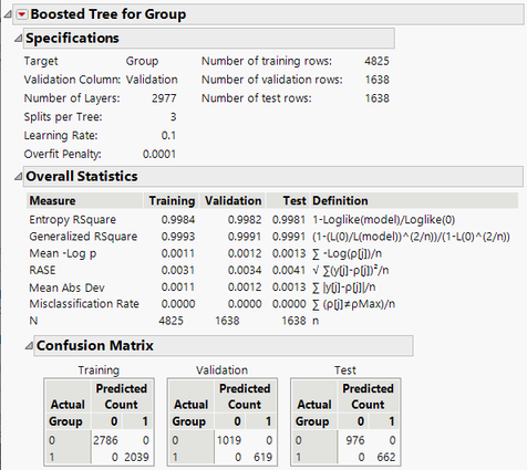

It looks like you used all of the default values for a boosted tree. Notice that a default boosted tree has 50 layers and your final results show that all 50 layers were used. That means that you can have a better tree by using more boosted layers. Here is a result when I specified a very high number of layers.
The support vector machine also provided a perfect fit according to misclassification rate. Why not consider that?
The only way to truly have confidence in a model is to start using it on new data. Why not go forward with all three (more layered boosted tree, neural net, and support vector machines) and let the data determine which one truly works better? Do you need to consider the speed of model evaluation in determining which one you use?
