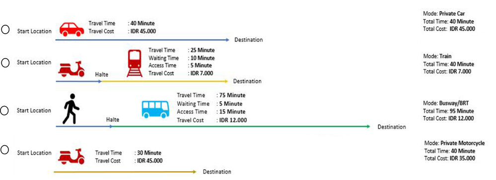

Thank you for the detailed feedback. I realize my initial explanation might have been a bit incomplete regarding the background of the study.
To clarify, the primary objective of this research is to analyze individual preferences in modal choice. Ultimately, I aim to determine the probability of an individual choosing a specific mode (mode share) and to identify the significant factors influencing those decisions.
Regarding your questions on the design:
  1. Varying Levels & Elasticity: The attribute levels are intentionally varied to measure individual elasticity (sensitivity) when facing increases or decreases in each factor. For instance, the travel time levels reflect different real-world traffic conditions (congested, normal, and free-flow) for private vehicles and buses. While a 90-minute bus ride might seem like an unlikely choice compared to faster alternatives, the bus fare is set as the lowest among all modes. This is designed to capture the trade-offs made by specific demographics (e.g., lower-income groups) who may prioritize lower costs over travel time.
  2. Separating Time & Cost Components: Regarding the separation of time components (travel time, waiting time, access time) and costs: Since two of the alternatives are public transport, previous transport literature suggests that these distinct components carry different weights in a user's utility function. Therefore, it is crucial to keep them as separate attributes rather than aggregating them into a single "Total Time" or "Total Cost" factor.
In the final questionnaire, respondents will be presented with random combinations of these attributes (Choice Sets) and asked to choose one of the four alternative modes. Each respondent will face, for example, 4 different choice scenarios.
Thank you for the guidance, I really appreciate it. The suggestion regarding "Custom Design" seems very applicable to my specific case, and I will definitely look into it further.
