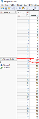

Hi JMP Community,
I want to check if the values of a row are consecutive and if it not then get the value of the first row which doesn't satisfy the condition.
For example : In this table, Column 1 has rows 1 to 15 that have consecutive values 1,2,3 and then row 16 has value of 12. So I would like to get the value of that first row that doesn't satisfy the consecutive condition.
Is there a more jsl way than using an iterator?
Thanks,
Jackie

One option would be to use Lag() or Dif() with Get Rows Where()
first_nok = Min(dt << Get Rows Where(Dif(:Column 1) > 1));

Awesome! Thanks Jarmo!
