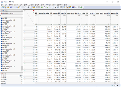

I'm trying to name a bunch of columns, 100+ of them. I have been doing a bunch of text-to-columns stuff and have many sets of three columns that I want to give the same names to. See below:
Above shows the columns with names that I want to have, to the left of the red line. It also shows the columns with names that I want to replace. As you can see, I'd like to change every third column, starting at n=1 (or whatever column number I want to start at), and every three columns after that (n+3), rename the column to "pX". The same goes for "num_after_pipe" and "value". All of them up to a point.
I'm working with the following script to rename every set of three columns"
dt_stack:"Data 1"n<<Set Name("pX");
dt_stack:"Data 2"n<<Set Name("num_after_pipe");
dt_stack:"Data 3"n<<Set Name("value");
dt_stack:"Data 4"n<<Set Name("pX");
dt_stack:"Data 5"n<<Set Name("num_after_pipe");
dt_stack:"Data 6"n<<Set Name("value");
dt_stack:"Data 7"n<<Set Name("pX");
dt_stack:"Data 8"n<<Set Name("num_after_pipe");
Any suggestions?
Thanks!

AlphaLion662
Level II
Re: Changing the name of every third (n+3) column(s) with specific name; 100+ columns
Hey StarfruitBob,
After fiddling around with it for a while, this worked for me. Thank you!
jthi
In your case you can also increment loop in 3s and set three columns at the same time in single loop
Names Default To Here(1);
dt = Open("$SAMPLE_DATA/Probe.jmp");
dt << Ungroup Columns(); // easier to see what is going on if we remove Responses column group
start_col_idx = 4;
colnames = {"px", "num_after_pipe", "value"};
For(i = start_col_idx, i <= N Cols(dt), i = i + 3, // we can increment in 3s
	Try( // lazy try-catch to exit when we cannot set more column names
		Column(i) << Set Name(colnames[1]);
		Column(i + 1) << Set Name(colnames[2]);
		Column(i + 2) << Set Name(colnames[3]);
		show(exception_msg);
		break();
