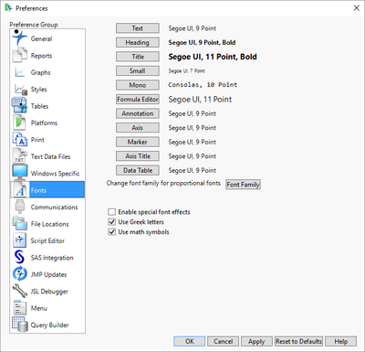

txnelson
Re: Changing the font size of point labels in a Contour Plot
You can change the defaults in the Preferences
File==>Preferences==>Fonts
Jim
Hi Jim, doing that will affect every chart in my output; unfortunately I need to restrict the change to just the one chart I'm working on.  Am I right in thinking this isn't possible?
Kind regards,
David
