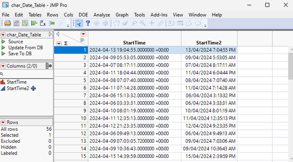

Hello,
Attached is a table with a column called StartDate. It is in char format and have excessive '0's at the end of each date. I wish to write a script to change the StartDate column to this format like : 04/12/2024 4:10:09 PM. Any help is appreciated.

Here is a little script that will create a new numeric date/time column converting your StartTime column values.
Names Default To Here( 1 );
dt = Current Data Table();
dt << New Column( "StartTime2",
	set each value(
		Informat( Word( 1, :StartTime, "+" ), "yyy/mm/ddThh:mm:ss" )
	Format( "m/d/y h:m:s" )

Thank you, this works!

maybe the easiest way:
open the column properties, and change the data type to numeric, then specify the pattern.
a) row 13 shows:
with the pattern <ss> Jmp automatically reads the seconds including the digits after the point.
b) The only thing that is not automatically detected is the timezone offset *)
→ if all values are the same, you can just add " +00:00" - to get it "ignored".
