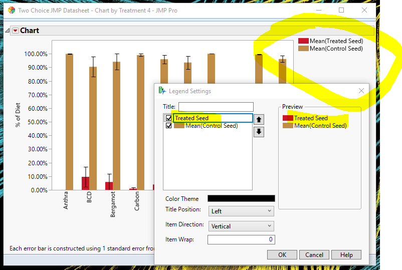

I'm creating a bar graph in graph builder and the default names on my legend are "Mean(Treated Seed)" and "Mean(Control Seed)". I would like to change them to just say "Treated Seed" and "Control Seed"  When I open up legend settings and rename the legend item, the preview indicates that the change has been accepted and displays exactly how I want it, but when I press the "OK" button, Nothing changes on my graph
Does anyone know why? or have other ways of changing the legend item labels?

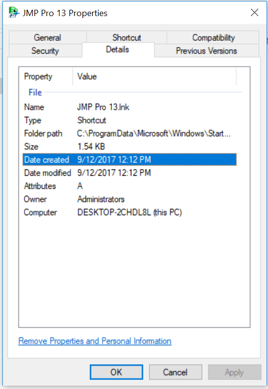

I'm using JMP Pro 13 on a Microsoft Windows 10 Home. I'm not sure how to tell what release I'm using but, the attached photo is what shows up when I open the program's Properties / Details
Also If it changes anything I realized that I said Graph Builder in my original post. I meant the Chart tool in the Graph pulldown menu.
