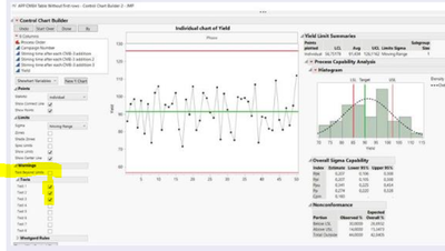

So I am using JMP software to add the first three violation rules for my automated control charts - which is fairly easy to enable (manually or scripting, shown here in the manual option):
However, JMP evaluates the warning rules to the control limits JMP has calculated (UCL/Avg/LCL as shown in the limit summary above). I would like for JMP to evaluate the warning rules to our internal "control limits" (which have been optimised by our R&D department.. in this case that is UCL 102, demand value (instead of Avg) 90 and LCL 85).

If you right-click inside the graph, you can select Limits->Set Control Limits.  This will allow you to set your own limits rather than using JMP's calculated limits.  You can also use the set control limits command via JSL (take a look at the Object Scripting Index for an example).
