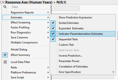

Dear JMP community,
I found that when fitting a multiple linear regression (y ~ X1 + X2, X1 is a continuous and X2 is a categorical variable), by default JMP defines the dummy variable X2 as -1 1. Is there a way to change it to 0 1, which will be the same as the default dummy variable coding as R? Thanks!

Hi @Jogger560 : In the red triangle pull down menu at the top of the Fit Model output, there is an option for Indicator Parameterization Estimates.
