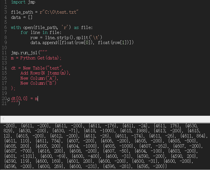

jthi
Re: Does python write data from memory to JMP only in a circular form?
Which feature? Data table subscripting and setting all values of data table from matrix?
You can set all values with run_jsl
import jmp
file_path = r"C:\Users\jarmo\Downloads\test(1).txt"
data = []
with open(file_path, 'r') as file:
    for line in file:
        row = line.strip().split('\t')
        data.append([float(row[0]), float(row[1])])
jmp.run_jsl("""
m = Python Get(data);
dt = New Table("test",
	Add Rows(N Items(m)),
	New Column("A"),
	New Column("B")
dt[0,0] = m
-Jarmo
lala
Level IX
Thanks Experts!
dt[0,0] = m
d2[0,0] = ar[0,0]
