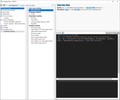

Scripting index also has an example, but this might require looping
or if you have JMP18 << Broadcast should work

var << (Variability Analysis[1] << Broadcast(Show Box Plots(1)));
