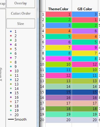

Although it's no longer relevant, to elaborate more on #2 -- when Value Colors are applied to a column, the sequential order of the colors that occur within the column are different than when the theme is used in graph builder.
In this image, the "Theme Color" column is a column that I filled 1 to 20, and then hit Value Colors->Color By Value->JMP Light.
The "GB Color" column is a column that I manually made that shows the sequential color order that appears in Graph Builder when JMP Light is applied to the graph.
After the 12th entry, the colors sync up, but before that they do not correspond to the sequential order within the JMP Light theme.
Not really important anymore, but I do still find this to be fairly strange behavior. Do you know why Graph Builder scrambles up the first 12 colors in the color theme?

Many thanks for taking the time to document this, Adam. I'll bring it to the attention of R&D.

The scrambling is my fault. Outside of Graph Builder, JMP will skip green when it needs two colors to avoid the common red/green color deficiency. However, Graph Builder is a little more dynamic and needs to be able to go from two to three colors without changing the first two colors, so it rearranges them from the start (each group of 3 gets a rotation around the color wheel). This only happens with the "JMP"-labeled color themes, so you avoid the dual sequencing by using a different color theme.

Haha, "fault" is a bit harsh -- this rationale makes perfect sense, thanks for the information :)
