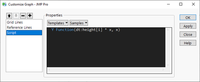

I'm trying to build multiple graph boxes, each one plots a Y Function that takes values from a data table. This should be an easy task however I'm not able to get the plots to show in the graph boxes. It works with hard coded numbers, but not with values from a Data Table
win = New Window("window", vlb = V List Box());
For (i=1, i <= N Rows(dt), i++,
	vlb << Append(Graph Box(Y Function((dt:M)[i] * x ,x)));
Any help would be much appreciated

If you look at the scripts that get created, you see that the values are not there
This is because you will have to evaluate them. Something like this should work
