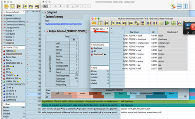

Till now I was copying the "source" script of the created table to glue them in one single script to automate the whole report (hence no script writing skill from the scratch)
Now I use Categorical »» Multiple Delimited »» Save Tables »» Save transposed frequencies but there is nor "source" menu to copy How to reproduce the whole steps to automate the report?
