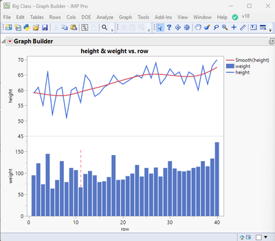

Can the vertical dividing line of the X-axis in the drawing only show part of it?
Thanks Experts!

I would suggest utilizing X/Y Origin() and X/Y Range() in cases like this
Names Default To Here(1);
dt << new column("R", Numeric, Continuous, Formula(Row()));
ar4 = [12.5, 22.5, 33.5];
gb = dt << Graph Builder(
	Size(534, 456),
	Show Control Panel(0),
	Variables(X(:R), Y(:height), Y(:weight)),
	Elements(Position(1, 1), Line(X, Y, Legend(11))),
	Elements(Position(1, 2), Bar(X, Y, Legend(14)))
Eval(EvalExpr(
	Report(gb)[FrameBox(2)] << Add Graphics Script(
		For Each({v}, Expr(ar4),
			Pen Color("red");
			Line Style("dashed");
			Line({v, Y Origin()}, {v, Y Origin() + Y Range()});
-Jarmo

I would use
     << Add Graphics Script()
and use the JMP Graphic Primitives' to draw the lines you need
Jim

Maybe better: invert the problem:
put a huge white rectangle into the plots where you DON'T want the lines - and move this layer on top of the lines.
This gives you the flexibility to adjust the lines via the GUI.

dt = Open("$SAMPLE_DATA/Big Class.jmp");ca="row";New Column(ca);Column(ca)<<Formula( row() );dt<<run formulas;Column(ca)<<deleteFormula;
p1=dt<< Graph Builder(
	Size(534, 456),
	Variables(X(:row), Y(:height), Y(:weight)),
	Elements(Position(1, 2), Bar(X, Y, Legend(14))),
	SendToReport(
		Dispatch({}, "Graph Builder", FrameBox(2),
			{Reference Line Order(3),
				2,
				Description(""),
				PenColor("red");
				LineStyle("dashed");
				ForEach({ref_line}, ar4, Line({ref_line, 0}, {ref_line, 160}));

Names Default To Here( 1 );
dt =
// Open Data Table: Big Class.jmp
// → Data Table( "Big Class" )
Open( "$SAMPLE_DATA/Big Class.jmp" );
// New column: Column 6
Data Table( "Big Class" ) << New Column( "Column 6",
	Numeric,
	"Continuous",
	Format( "Best", 12 )
// Change column name: Column 6 → row
Data Table( "Big Class" ):Column 6 << Set Name( "row" );
// Change column formula: row
Data Table( "Big Class" ):row << Set Formula( Row() );
Graph Builder(
	Size( 534, 456 ),
	Show Control Panel( 0 ),
	Variables( X( :row ), Y( :height ), Y( :weight ) ),
	Elements(
		Position( 1, 1 ),
		Line( X, Y, Legend( 11 ) ),
		Smoother( X, Y, Legend( 10 ) )
	Elements( Position( 1, 2 ), Bar( X, Y, Legend( 5 ) ) ),
	SendToReport(
		Dispatch( {}, "Graph Builder", FrameBox( 2 ),
			{Add Graphics Script(
				2,
				Description( "" ),
				Pen Color( "red" ):line style( "dashed" );
				Line( {11, 0}, {11, 160} );
		Dispatch( {}, "400", LegendBox,
			{Legend Position( {11, [2], 10, [0], 5, [1]} )}
Jim
p1 = dt << Graph Builder(
	Size(572, 501),
	SendToReport(
				2,
				Description(""),
				PenColor("red");
				Line({10.5, 0}, {10.5, 160});
				Line({20.5, 0}, {20.5, 160});
				Line({30.5, 0}, {30.5, 160});
