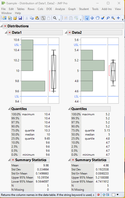

For pt 6, here are my sample data and resulting charts:
For the chart in this example, 1st and 2 rows of data are plotted in as well, which I don't want it to. They are the LSL and USL respectively. What I do normally is that I don't include the LSL and USL in the data.

Here is an example script that produces what you want

// Exclude and Hide row 1 & 2 to eliminate them from Distributions
dt << Select rows( {1,2} );
dt << hide and exclude;
// Run the Distribution Platform, having the Spec Limits as
// Column Properties, will insure the proper Min and Max for
// the Y axis
dt << Distribution( column( eval(colNameList) ));
