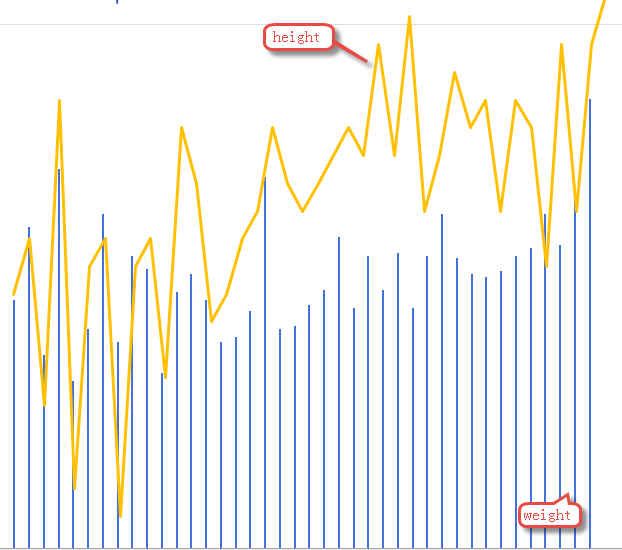

Can JMP draw this pattern?
Hello!
Draw a horizontal bar chart of height data,
Graph the data on weight.
Superimpose two graphs on one graph.

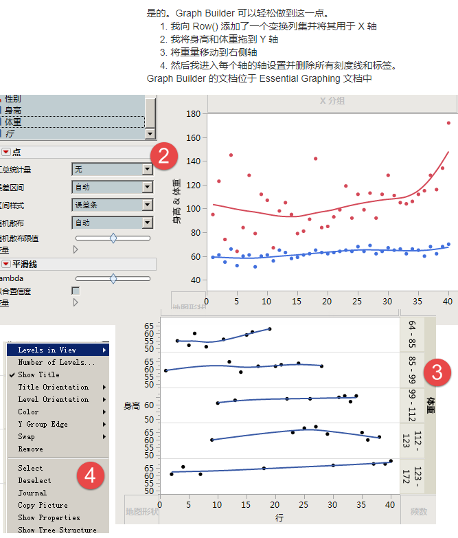

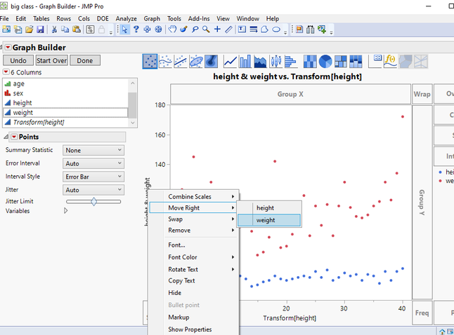

Yes.  Graph Builder can easily do this.
  1. I added a transform column set to the Row() and used it for the X axis
  2. I dragged Height and weight to the Y axis
  3. Moved Weight to the right side axis
  4. Then I went into the axis settings for each axis and removed all tick marks and labels.
Documentation on Graph Builder is in the Essential Graphing document
Jim

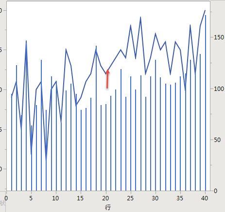

Re: Can JMP draw this pattern?
Thank Jim!
I tried to do it, but at step 4 I couldn't figure out how to do it.And I don't know if I'm dragging correctly?
txnelson
Do not create a Group Y, you need to move the axis to the right,.
Jim

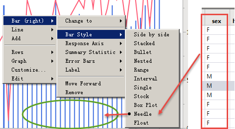

After this, how to use different colors for the "weight" bar chart according to the "gender".Does this "needle" shape reflect different colors?
I still need expert help.
