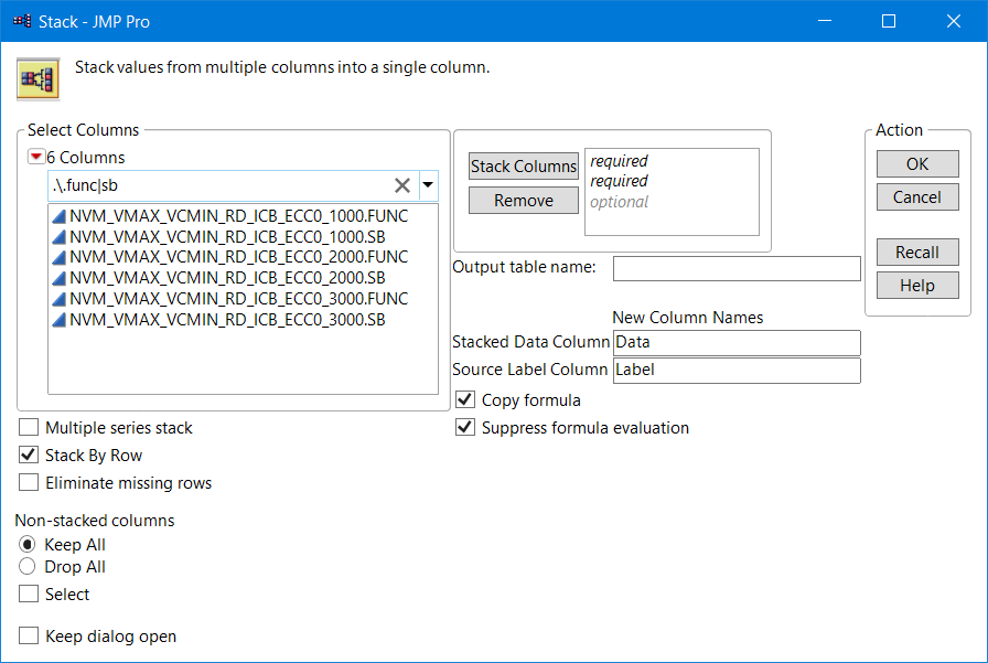

@OneNorthJMP , I think @ian_jmp 's solution is the most flexible.
Extending Ian's first suggestion:
  • Use the red menu to Show Filter
  • Then use the black menu, to the right of the magnifying glass and select Regular Expression and Ignore Case.
  • Then type in .\.func|sb that is is period, escape (\), period, func, or (|). sb. The screenshot is shown below.  Of course if you wanted the leading name, type this string [nvm_vmax_vcmin_rd_icb_ecco_]?.\.func|sbimage.png
The downside to this approach is that it requires knowledge of some basic regular expression syntax.

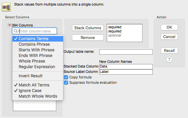

Take a look at the 'Show Filter' option under the red triangle in your screenshot above:

To be clear, (and on a Mac) clicking on the magnifying glass you get with 'Show filter' will bring up the required context menu . . .
