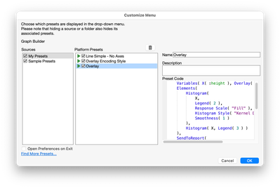

You can find the presets from PlatformPresets.jmppresets file. This makes it easier to see what the presets are trying to do. For windows I think they are found from C:\Users\<username>\AppData\Roaming\JMP\JMP\. You can also access the JSL this way: select the Platform Presets button, and press Shift and select Customize Menu.  More info possibly from different pages of Using JMP > Platform Presets .

As Jarmo pointed out, you can edit the platform presets file directly from its location on disk. Alternatively, you can make edits to your saved platform preset definitions by holding down the shift key before clicking on the preset icon > Customize Menu..., which will reveal the preset code section in the menu editor for you to make changes. Ordinarily that's not something we suggest, but in some cases it's useful which is why we have that method available.
