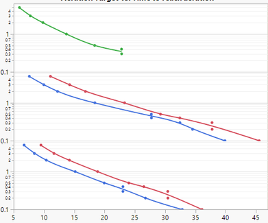

Can I change style of smoother line?
I made a Graph with a Graph builder and I would like to adjust the line type of all three lines created with a smoother to "dashed" style.
Is it possible by editing the script somehow?
I thought I could simply add a linestyle command somewhere, but cannot figure out where.
Thank you very much!
Graph Builder(
	Size( 567, 456 ),
	Show Control Panel( 0 ),
	Variables(
		X( :Time to reach aeration ),
		Y( :Aeration Target ),
		Group Y( :Type filter ),
		Overlay( :Rating )
	Elements(
		Points( X, Y, Legend( 16 ) ),
		Smoother( X, Y, Legend( 19 ), Lambda( 0.0025 ))

I don't know about your script, but if you select the line in Graph Builder and right click on it, you get the option to Customize... select this and you will get the option to change line styles.

there is script for that, please see below
Graph Builder(
	Size( 528, 448 ),
	Graph Spacing( 3 ),
	Variables( X( :SimulatorDate ), Y( :BinPct ), Overlay( :Plant ) ),
	Elements( Points( X, Y, Legend( 3 ) ), Smoother( X, Y, Legend( 4 ) ) ),
	SendToReport(
		Dispatch(
			"400",
			ScaleBox,
			{Legend Model(
				4,
				Properties(
					1,
					{Line Style( "Dashed" ), Fill Color( 0 )},
					Item ID( "DMT1", 1 )
Thuong Le
