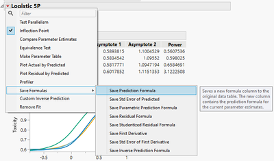

Save Formulas

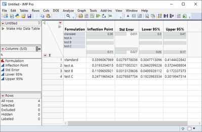

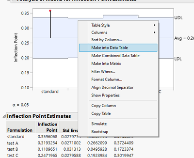

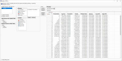

or maybe in this case Make Into Data Table (right click on your table box in report) + Join/Update to original table

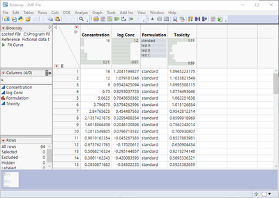

Starting data
Make into data table
Update (change settings as needed)
