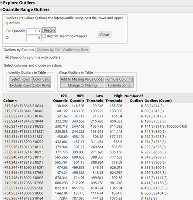

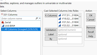

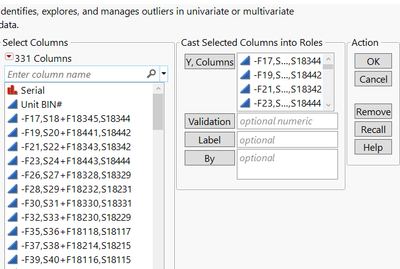

Explore outliers is meant to handle as many columns as you have in your data table, but you have to be sure to select them all when you start the analysis.  Below is an image of where all of the columns in your wide table are selected.  One way to help with this would be to group your columns so that you only have to highlight the group to move all the columns at once.  You can see the difference with and without grouping in the first two images below.
