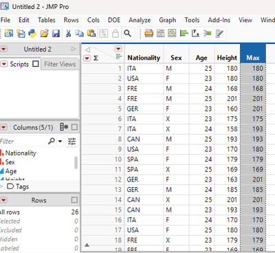

Hello,
I would like to find the maximum value from a column, but I need to group the data based on other columns; is it possible using a formula or a script?
As example, I would like to populate a new column with the maximum height, but divided by age, sex and nationality:

txnelson
Re: Calculation grouped by variable
Col Max( :Height, :Age, :Sex, :Nationality )

DiCosimoA
Level I
Thank you so much! That's exactly what I was looking for!
