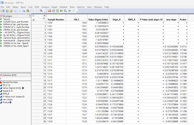

I think you can get what you want from the Linear Regression() function.  Take a look in the Scripting Guide for the definition and example of how to use it.  Below, I created 2 new columns, "New Slope" and "PValue".  I set the format for the PValue column to "PVALUE".  I then set the formula for the PValue column to
If( Row() > 7,
	dt = Current Data Table();
	x = dt[Index( Row() - 7, Row() ), 2];
	y = dt[Index( Row() - 7, Row() ), 3];
	{Estimates, Std_Error, Diagnostics} = Linear Regression( y, x );
	:New Slope[Row()] = estimates[2];
	diagnostics["p_value"][1];
Here is the display
If( Row() > 7,
Here is the display
