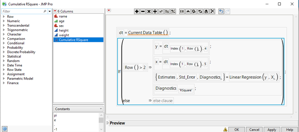

A JMP formula can pretty much be anything you want it to be.  My pointing you to the Linear Regression() function in the Scripting Index, happens to show it's example in the form of a script, but the function can also be used in a formula.  Below is a silly example, of calculating the regression for first rows 1-3, then 1-4, 1-5, etc. for all of the rows in the Big Class data table.  Here is the formula...….attached in the data table with the new formula column added
Jim
