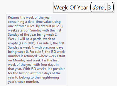

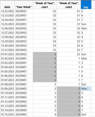

Besides different days for "first of week", it's also a bit surprising, how Week of Year is calculated in general.
Especially when comparing "Week of Year" and "Year Week" (from the new formula context menu).
In 2023, Rule #3 was more than 1 week delayed compared to Rule #1:
