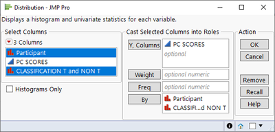

You can for example use Distribution with By columns
Then add Customize Summarize statistics and Quantiles as you need to

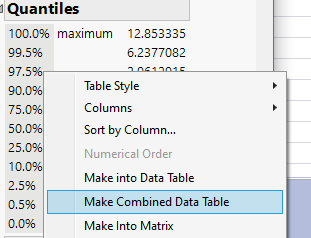

After that, you can right click on the tables in the platform and create Combined Data Table
Then you can combine those two tables with Concatenate (might require some column renames)

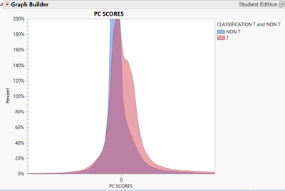

Thanks Victor & @jthi, for you useful suggestions, however thinkk there is a misunderstanding so I need to clarify more clearly my task. I need to make a classification model for two movement types T and NON T. As shown in graph below the PC Score distributions of T & NON T (cfr. file above in attachment) are different so I need to find a model based on the score distribution characteristics. To do so, for all 16 participants I want to draw samples of 100 consecutive rows from each movement type and report in rows of a new table the distribution properties so I can generate a ML binary classification model T/NON T.
Hope this is sufficiently clear; how to create a table with in rows, for all participants, the T/NON T distribution properties of 100 row samples?
