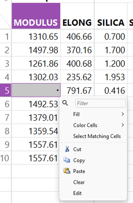

The model that is made in the column is always going to calculate for every row, agnostic of the presence of any other missing values in other columns. That being said, you can always hide and exclude the rows where those missing values exist. Just click the empty cell in the original column, right click and click "select matching cells", then go to Rows>Hide and Exclude.
