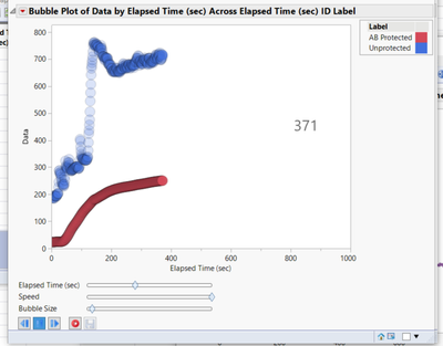

I am drawing an animated bubble plot with time as the x-axis as well as the time.  My data is recorded every 1 second.  Is there a way to calibrate the Speed slider such that the plot is drawn, one point every second to match the data?

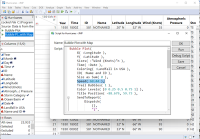

There is a speed statement in the bubble plot. What i do not know is what units it uses. higher is faster so it is not a derivative of the cycle.
try using the value of 1 or around that unit. to me it looks close enough to once a second

Perhaps I need to clarify a little bit: I would like to know what speed setting equals 1 sec per new data point / row appearing on the chart.

Bubble Plot animation currently works on the time levels [0, n-1], and not directly on the time values.  Since you have regularly spaced data, it should be possible to get close to what you want, so I'll describe what JMP is doing.
Animation speed is controlled by changing two factors:
  1. A delay between each frame (from 1-60 frames/sec)
  2. The increment in time level between each frame
At the default speed (10):
  1. A frame is shown every 1/15s
  2. Time advances by .1 levels between each frame shown
With constantly spaced time, you should see time advance at roughly 1.5 levels/sec.  Changing the speed will have a linear effect (up to the min/max), so if you want to advance at n levels / sec you can use speed = n*20/3.
