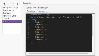

Right click on the graph, select Customize, press "+" and then you can add new graphic script. This isn't anything specific to bubble plot and works in all of the graphs in JMP.
-Jarmo
Re: Bubble Plot Display in JMP
@madhu
You can add the custom graphics (markers, text, lines, etc.) using JSL by using the command << add graphics script. The scripting index has many examples on the possibilities.
I updated your original script with Jarmo's suggestion. I think you should be able to modify this to your specific script.
// assign the bubble plot to a variable
bp = Bubble Plot( X( :LON ), Y( :LAT ), Sizes( :WIND ), Time( :Date ), Coloring( :STAT ), Title Position( -73.86, 8.76 ), SendToReport( Dispatch( {}, "LON", ScaleBox, {Format( "Best", 9 ), Min( -81 ), Max( -39 ), Inc( 10 ), Minor Ticks( 1 )} ), Dispatch( {}, "LAT", ScaleBox, {Scale( "Geodesic" ), Format( "Best", 9 ), Min( 2.25 ), Max( 33.75 ), Inc( 5 ), Minor Ticks( 0 )} ), Dispatch( {}, "Bubble Plot", FrameBox, {Background Color( 73 ), Background Map( Images( "Simple Earth" ), Boundaries( "World" ) )} ) ) );
// find the framebox in the bubble plot for the graphics script fb = report( bp )[framebox(1)];
// add the custom script fb << add graphics script( Marker Size(5); Marker([-40, -50, -60, -70], [5, 10, 15, 20]); text( {-40, 5}, "Station 1", {-50, 10}, "Station 2", {-60, 15}, "Station 3", {-70, 20}, "Station 4", ) );
 You will now notice that this graphics script is saved to the graph when you right click >> Customize...
