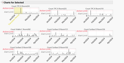

Not asking a question here, but prompting a solution I've found for when you want to add axis settings from one chart to many others in the process screening platform. For example, I want to take this customisation I've done on this chart in the top left and add it to all the others:
If you right click the graph axis (say the X) and 'Copy Axis Settings' then run the script below, it will translate those settings to all of your other charts - just let the script now if its an X or Y axis you're changing.
