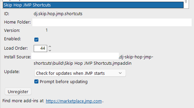

View > Add-Ins and you should find Assistant and then you can unregister it. Not sure if it will uninstall the python packages, if it doesn't you would have to go and manually delete them (if you want to).

Update:  JMP is back to behaving normally (so far).  I restarted my computer!  Amazing how often that solves problems.  In any case, I would still like to uninstall Assistant since it doesn't work well for me.  I don't understand your suggestion:  how do "unregister" the addin?  I don't see any option for unregistering it.

Not Assistant but it should be the same for that
Scripting Guide > Creating Applications > Create Add-Ins with the JMP Add-In Builder > Manage JMP A...
You can also remove the files manually, but I'm 100% sure that JMP will properly clean it from menu items if you do that. For windows add-ins are saved to %appdata%\JMP\JMP\Addins (C:\Users\<USERNAME>\AppData\Roaming\JMP\JMP\Addins)
