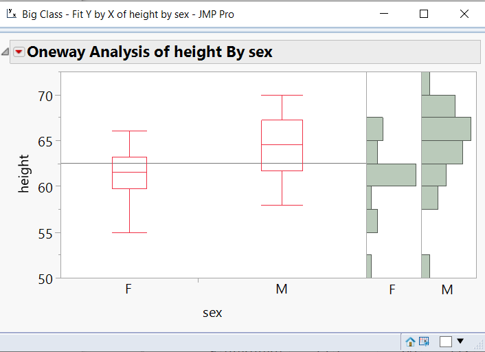

The default box plot with histograms in JMP is:histo1.PNG
By clicking on the red triangle under the output from the Fit Y by X platform, the histograms can be selected.

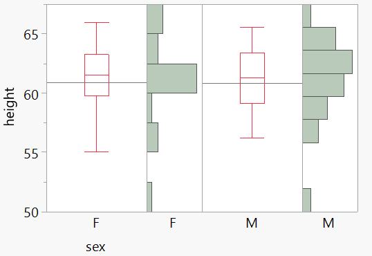

Additionally, if you get into scripting, you can do just about anything you want, such as the below mock up of one possible style

This look closer than what i want.
