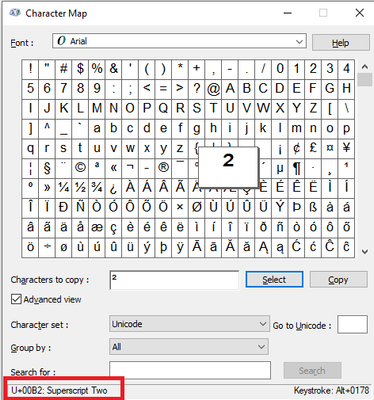

jthi
Re: Box-plot with points aligned in box plus violin plot
If you are using Windows you can also find these from Character Map:
There is also an option to create addin / custom function to do this. This wouldn't be perfect, but it could be helpful? Here is quick example of possible function (I would make it more robust if I were to create one):
