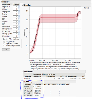

Hello,
I am performing a bootstrap on some data created using the mixture distribution function as part of the life distribution to calculate reliability. I am using the bootstrap data to develop confidence intervals for the mixture distribution parameters. The 5 parameters estimated are sigma 1&2, mu 1&2, and portion which is what I am creating the bootstrap for. I am not designating a random seed and left as a '.', I am using fractional weights though with a generated sample size of 2500 as the standard input. The question I have is should this bootstrap normally take 1.5 hours or so? It seems to be pretty long and I was discussing with a coworker that this doesn't seem right and to get my computer checked out as the processing speed may be low. But my computer is fairly new, I have a Dell Precision 7560 with i7 intel processor 2.50GHz and 32GB of RAM, so I am curious if the long time for bootstrapping is typical or if there is something else with JMP I should look into?
Thanks for the help!

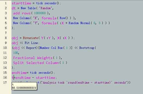

Re: Bootstrapping takes a long time
JMP Pro 14、core i5
66

Hi @Georg,
Thanks for the benchmark! I ran it and it took me 77 seconds, so I think the issue is more in regards to the computationally intensive method of the bootstrap for estimating the statistical parameters from the mixture distribution data, as @peng_liu pointed out in a later response. I attached an example of the parameters I perform the bootstrap on which takes the 1.5 hours.

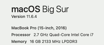

194 seconds
Windows 10
11th Gen Intel(R) Core(TM) i7-1185G7 @ 3.00GHz 3.00 GHz
16.0 GB (15.7 GB usable)
JMP Pro 16
With many applications running concurrently in RAM.
