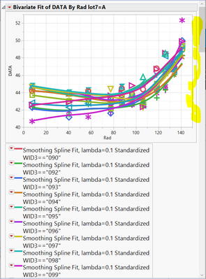

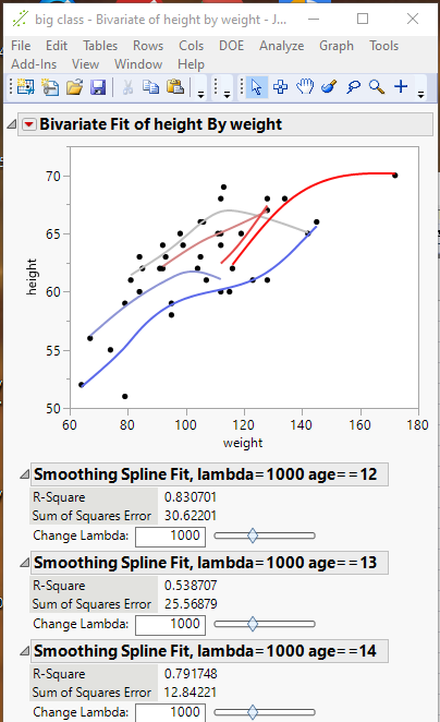

I would like to my plots simple after fitting each values. I have searched some solutions, but it is not working to my case.
I want to delete the box containing all of the "Fit Each Value" line items. It looks that it can be done with report(biv)[PictureBox(2)]<<delete;. But unfortunately, "Fit each value" is not "PictureBox". Instead, it looks "Segments" from display trees. How could I address this issue so that make plot looks better?

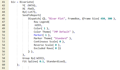

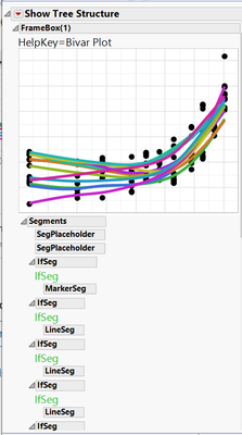

I have tested but nothing changed. I have included my script. Could you please take a look and give advice?
Thansk,
Jun Sung
--- coding format broken when I paste it so that reading is not strightforward. please check screen capture in above.
biv = Bivariate(
	Y( :DATA ),
	X( :Rad ),
	By( :Lot7 ),
	SendToReport(
		Dispatch(
			"Bivar Plot",
			FrameBox,
			{Frame Size( 450, 300 ), Row Legend(
				:WID3,
				Color( 1 ),
				Color Theme( "JMP Default" ),
				Marker( 1 ),
				Marker Theme( "Standard" ),
				Continuous Scale( 0 ),
				Reverse Scale( 0 ),
				Excluded Rows( 0 )
	Group By( :WID3 ),
	Fit Spline( 0.1, Standardized )

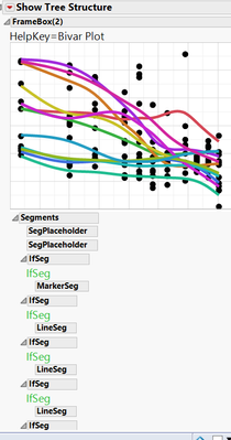

Re: Bivariate Fit - how to delete fitting lines and results

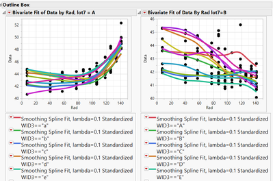

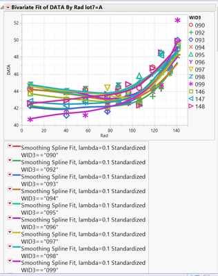

There is some deletion with looping. But, it actually deletes legend. How could I edit script to delete fitting lines?
Thanks,
Jun Sung
Before looping script:
With looping script:
If you have a row legend, the fitted-lines box would be the third PictureBox of each bivariate sub-report.
This should work:
xp = (biv << xpath( "//PictureBox" ));
For( i = N Items( xp ), i > 0, i--,
	xp[i][3] << visibility( "collapse" )

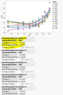

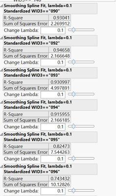

Wow. It is great~~~ Could I ask one more question?
Fitting lines are deleted. But, I would like to delete fitting curve results. I have tried [4], but it is not working. Could you please give great advice?
