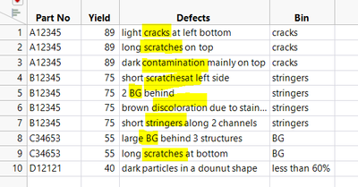

I have attached table1 which consist of 3 input columns (Part No, Yield and Defects) and 1 output column (Bin). I have also attached another priority_table stating the hierarchy of the defects with cracks as the most important.
How do I generate the output column Bin, using JMP scripting where if a Part No has a few defects, put the most important defect in the Bin column for all the rows concerning that Part No.? Also if the yield is less than 60% and the defect is not on the  priority_table than bin into "less than 60%"?

I updated my question and Table1.jmp. The Defects column is keyed in manually by operators and the defects words like cracks, stringers...etc are among each string.
