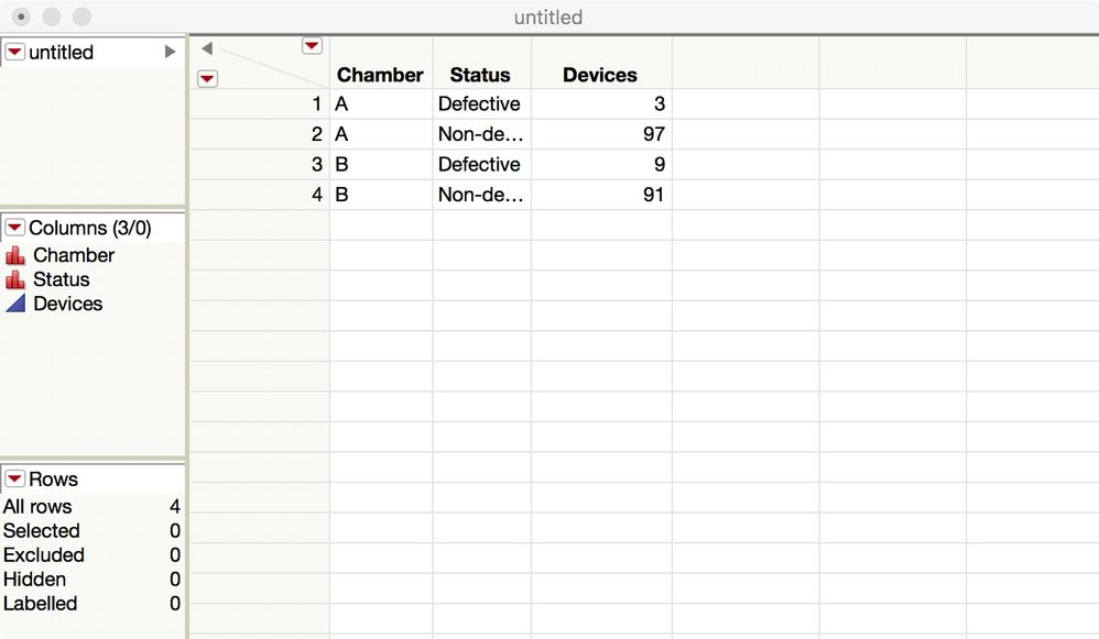

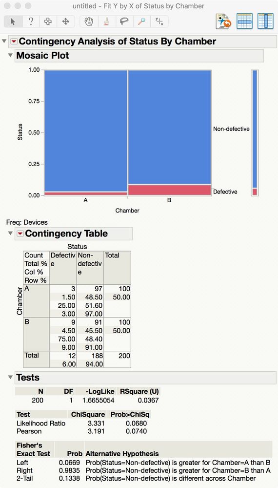

If the problem is as simple as you describe (compare two failure rates), then you can use a contingency table analysis. Try these steps:
  1. Enter your data as Chamber (A,B), Status (Defective,Non-defective), and Devices (counts).
  3. Select Status and click Y.
  4. Select Chamber and click X.
  5. Select Devices and click Freq.
Here is what my data table looks like, based on your example:
Here is the result of the analysis:
Does this approach help?

I agree with Mark's suggestion, but make sure you know exactly what question you want to ask.  Mark's continency table will answer the question whether the failure rate differs after 3 months.  If you want to answer a more general question - do the failure rates differ - then your data probably is censored, meaning that you have a measurement after 3 months, but the lifetimes are actually longer.  I suspect the two analyses will yield similar qualitative comparisons, but not quantitatively equivalent.
